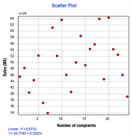

The other important characteristic of a good CQA system is that the metrics used to measure customer satisfaction are related to the company’s financial performance. For example, you might have the wrong metric if you correlate your CEO’s favorite customer-satisfaction metric, number of complaints, with the sales for the same time period and you get this:
Testing the Pearson’s r of 0.2706 for these data indicates that this isn’t a significant correlation (if the fact that it looks like a shotgun blast didn’t convince you in the first place). In desperation, you might even see if the number of complaints is a leading indicator and correlate it with future sales, but (since I made up these data) that turns out to be fruitless as well. And you get the fun job of explaining to the CEO that his or her favorite metric is, in fact, bogus, at least in terms of making the company money.
Sometimes finding a satisfaction metric that relates to key business metrics isn’t a trivial exercise, but in the absence of some sort of predictive validity, you could spend a lot of time increasing customer satisfaction and go out of business with the happiest customers around.
So in our example above, why were our customers not buying more of our stuff when they had fewer complaints? One company found that of their customers who had problems with their product, 55 percent were satisfied, but of those who had no problems, only 75 percent were satisfied with the product. Just because you don’t have a complaint about a product doesn’t mean that you’re satisfied with it. Satisfaction is achieved by meeting customer expectations, and only some of their expectations are covered by a warranty or are “complainable.” These expectations are a moving target, and your CQA system is what feeds that information back into the business. A fancy feature today is tomorrow’s expectation.
