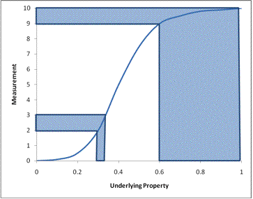

If there’s something in the order of the data, but the difference between, say, a 1 and a 2 may be different than the difference between a 2 and a 3, you have ordinal data. An example of this might be ratings or rankings. If you go to the doctor and she asks you how much it hurts on a scale of 1 to 10, the number you choose is ordinal. The difference between a 3 and a 4 isn’t necessarily the same as between a 9 and a 10. If we were to graph the relationship, we might find something like this:
Figure 1. Ordinal level measurement’s relationship to the underlying property
The curved line is the actual relationship between whatever you’re interested in and the numbers that you get from your measurement system. This shows how the difference between a 2 or a 3 measurement is smaller than the difference between a 9 and a 10. If I get a 2 on my measurement device, I draw a line from the 2 to the relationship line, then follow that point down to the x-axis, I get the “real” number for the underlying property in which I’m interested. Of course, in real situations we either don’t know or can’t measure the true underlying property (e.g., the “true” pain at the doctor’s), but we can tell how the measurement is related to that property.
With ordinal data, you can take a mode or a median to describe the location of the data, you can do any order-preserving transformation, and you can use many nonparametric statistical procedures to determine differences, such as the sign test for location or the Mann-Whitney U test. You cannot use something like the t-test reliably, however. I have seen many people do this, especially in survey analysis, and you can very well come to the wrong conclusion if you do so.

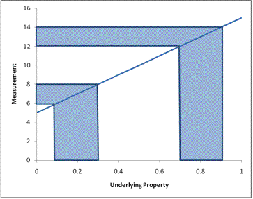

Data are interval scale when the differences between any two numbers correspond to proportional differences in the underlying property. Our temperature example is of interval level. Height above sea-level would be another one. If you were to graph the relationship, it might come out like this:
Figure 2. Interval-level measurement’s relationship to the underlying property
You’ll notice that the line doesn’t go through the 0,0 origin point, and that’s characteristic of interval data. Here you can see that an interval, for example, the difference between a 6 and an 8, results in the same difference in the underlying property as for a different equal interval, say between 12 and 14.
With interval-level data, you can calculate means and standard deviations (though if the data are non-normal, the standard deviation doesn’t tell you much) and use many statistical procedures, like the t-test, as long as their assumptions are met. You can do any linear transformation on these data as well.
