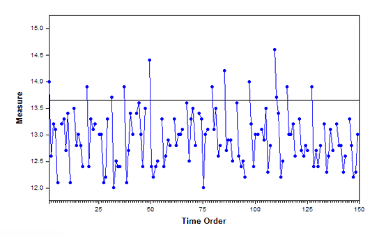

In the manufacture of resin parts, a critical measurement was made on five parts each day for 25 days. The first part was measured at 6:00 a.m., and another part was measured each four hours thereafter. The data were kept in time order to make an Xbar & R chart with the usual 3-sigma limits, having 25 subgroups (days) of size five (times of the day) (Figure 1). The highest values on the Xbar chart and on the R chart both occurred on Day 19. With random normal data the Xbar values and R values are independent, so the probability of such a coincidence is too small to attribute the signal to chance. However, we’ll overlook this, as Ishikawa did, and discuss the inflated control limits.
Ishikawa concluded that the process was in a state of control with only common-cause variation arising from what appears to be random data. This conclusion was grossly in error and was the result of inflated control limits. The mistake easily could have been avoided.
Figure 1: Xbar & R chart subgrouped by day with subgroups of size 5
Dr. W. Edwards Deming strongly advocated the use of run charts, simple time-ordered plots of the individual measurements, for data analysis. During a conversation with Dr. Deming in 1980, one of his associates stated that a particular client "didn’t have enough sense to make a run chart before he made a control chart." The run chart for the resin data is shown in Figure 2, where it’s been interrupted between days making the within-day pattern clearly visible. The run chart enables you to focus on peculiarities in the individual measurements, which might suggest nonrandom special-cause influence.
Figure 2: Run chart interrupted by day.
The most glaring feature of the run chart is that in 21 of the 25 days the startup measurement was the highest. It’s not random. The false message delivered by the Xbar & R chart was due to poor sampling, resulting in within-subgroup stratification and inflated control limits. The variation between times of the day, which should have been made part of the between-subgroup variation, was improperly made part of the within-subgroup variation, inflating the control limits and rendering the control chart useless.
