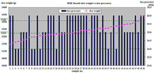

Figure 6. Plot of tire pressure vs. tire weight
The plot illustrates that all 50 samples hold tire pressure at 24.0 psi and above, and that the tire pressure does not strongly correlate with tire weight when it is more than 1,150 g. When rubber tire weight is not less than 1,230 g, however, 92.3% percent of tires hold pressure at 25.0 psi and higher. When rubber tires weigh between 1,150 g and 1,230 g, 75.0 percent of them keep pressure at 25.0 psi and higher. Additionally, the zero defects corroborate the combined contribution of seal layer thickness and wire ring ID.
