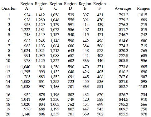

Figure 7 provides a second example of how administrative data are often arranged into subgroups. There you will find the quarterly sales for each of six regions for the past five years. These values have been arranged into 20 subgroups of size 6 so that each quarter is a subgroup.
Figure 7: Quarterly sales for five years
The grand average for the subgroups of figure 7 is 803. The average range is 836. The average and range chart for these 20 subgroups is shown in figure 8. Before you attempt to interpret figure 8 you need to answer two questions regarding the subgrouping used. These questions are: What type of variation occurs within the subgroups in figure 7? What type of variation occurs between subgroups in figure 7?
Figure 8: Average and range chart for quarterly sales
What is the problem with the subgrouping in figure 7? Are the subgroups internally homogeneous? It is the region-to-region variation that occurs within the subgroups in figure 7, while the quarter-to-quarter variation shows up between the subgroups. Is the region-to-region variation the proper yardstick for characterizing the variation from quarter to quarter? Would it not make more sense to acknowledge that the six regions are different, and then to track each region separately on an XmR chart?
