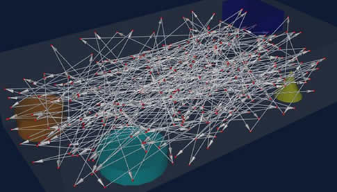

API’s software generates a specific measurement plan defining a complex path for the machine tool to follow, avoiding all obstacles during the measurement process. Within the machine’s working volume, between 200 and 400 random points are generated to represent all of the possible machine poses in each axis as the final measurement plan. During measurement, API’s T3 laser tracker will follow the machine tool center point as it moves along this predefined path, fully exercising the machine tool’s complete functionality. The software simulation ensures these random points are collision-free and will not break the laser beam from the Tracker3 to the Active Target which is loaded into the machine spindle during measurements.
At this point the actual measurement can begin. It takes between one and three hours to measure the entire machine regardless of size or complexity. Due to its extremely compact design and the industry’s largest working volume, the T3 laser tracker can be mounted either inside or beside the machine tool. The Active Target is mounted to a spindle which is inserted into the tool center point. The Active Target is a motorized SMR which continually moves the internal retro-reflector, keeping constant beam lock and measurement contact with the laser tracker. As the machine tool moves to each new point, it comes to a stop. There is a few second dwell to allow the machine to come to complete rest and stabilize in its desired position. The T3 laser tracker then measures the point between 30 and 100 times in about three seconds. Once this measurement is averaged and recorded the machine tool moves to the next position in the measurement plan.
There are three measurement runs; the first attaching the Active Target with a long tool adapter and a second run that repeats this run for validation. A third and final measurement run is done attaching the Active Target to a shorter tool adapter. This not only measures every point three times but actually produces a vector for each point by using both the long and short adaptors. This method yields extremely accurate positioning data as well as orientation data for each point in the measurement plan. The 300–400 points now form a point cloud defining the working volume as a block rather than simply three adjacent planes. In addition to the point cloud there is a virtual bar connecting each point to the one measured before and after it.
As shown in the picture below, these vector points and connecting bars begin to completely define every point in the working volume. Performing tens of thousands of calculations, the position of any given point in the volume can be accurately determined defining both position—X, Y, and Z, and orientation—pitch, yaw, and roll. From here the software can automatically calculate the necessary compensation values needed to bring the actual position of the machine tool center point to the desired or commanded position. These compensation values are stored in a table which will later be loaded into the machine controller to perform real time compensations.
