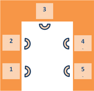

U-shaped work cells (see figure 7) are commonly used to optimize administrative value stream motion economy.
Figure 7: U-shaped work cells
