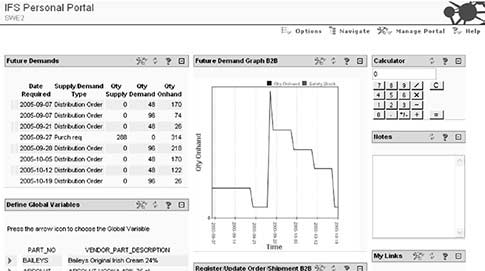

The solution was to set up a supplier portal (see figure 1) so that the packaging vendor and other suppliers could look into the production plan and prepare their own schedules accordingly. This eliminates a lot of the manual and administrative work involved with interfacing with a supply chain partner in real time, removing all manual intervention and administrative delays.
https://lh3.googleusercontent.com/D5gTFSknQjzUF-WCzb355KmJ4gMi3UJ7feKme_MopRzBMt7ZtbvCmOKvQ5l8vi26GQuGRpHmOvV4oWwZ7a0Vf3jvk2aFc3H6nXAFnYMwZAhdAo3XtCA
Figure 1: A supplier portal eliminates administrative waste and integrates the supply chain in real time
Portals of this nature can also provide a longer view of anticipated production so that vendors can manage their own inventories and plan their own capacity according to anticipated demand.
