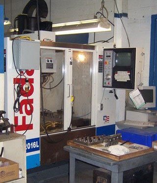

It all began in 2004, when CSS began to see more customers looking to get higher precision parts off a progressive tool. CSS had decided that CNC machining was the way to go, and began researching and learning all it could about the process. It jumped into the CNC world by purchasing a used Fadal machining center. After engineering and designing its own fixtures, it was off and running.

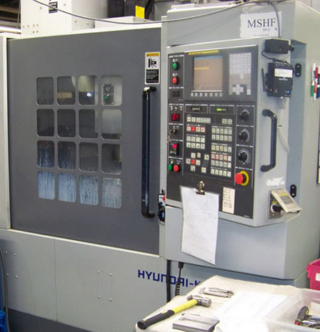

Robert Allen, CSS director of engineering for tooling and metal form, notes that the company was no longer looking at holding ±0.003 tolerances, but instead was asked to hold tolerances of ±0.0005. To achieve these close tolerances would require a very accurate CNC machine, and after doing a great deal of research, CSS settled on the Hyundai Kia VX400.
https://lh5.googleusercontent.com/-SVZWeV-gJEdG3MBLPbgAvPNGTjcMZPkOq-_xD5WIZOihZGjoDxLsb4HhIoNU0ndkBn5x5l0jhJqFo64GeiupMxhZ7Wqbkie6MqYgAn8EKsTpHoTx_0
Hyundai Kia VX400
“These machines are significantly more accurate than our first machines and are able to hold tight tolerances all day, every day,” says Allen. “We have also taken on a five-axis machining job using a rotary table and all the machine’s capabilities.”
