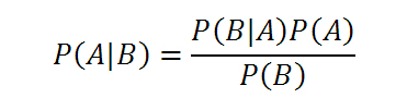

But first, let’s talk about a little thing called “Bayes’ theorem.” (You know me; I couldn’t pass up an opportunity to bring stats into the discussion.)
Now Bayes’ theorem is pretty simple in terms of probabilities but has far-reaching implications for those of us who live in reality (note that I specifically exclude most politicians from this clade). It is also almost never applicable in solving problems in industry, for reasons that will become obvious soon. That does not mean it is unimportant—the principle underlies how science actually works, even if is not going to help you design an experiment in industry.
Bayes’ theorem looks like a bunch of gobbledygook:

And that is the last time I’ll refer to it that way because we only need to use simple probability to understand what is going on. (There are plenty of sources you can tap to learn more about Bayes’ theorem. Probably my favorite is this one, which really helps you grasp the implications.)
