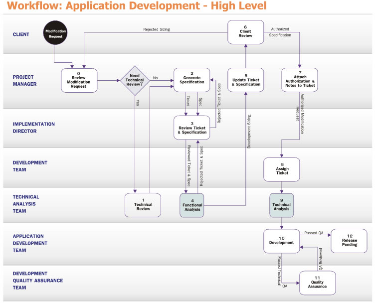

Better used a business process analysis (BPA) tool (as illustrated in the workflow figures below) to show the “as is” development process. Each “swim lane” represents a role and each step in the value chain was depicted.
Click for larger image.
