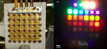

As reported in the July 1, 2012, edition of the journal Applied Optics, the NIST team has combined 32 LEDs—each generating light from different segments of the solar spectrum—and other off-the-shelf equipment with their custom-made technologies to build a system that measures the wavelength-dependent quantum efficiency of solar devices over a relatively large area.
Sections of the new NIST measurement system’s LED plate are shown here. A water-coolant system on the back (a) keeps the operating temperature constant. Collectively, the different-colored LEDs (b) generate light in wavelengths covering much of the solar spectrum. LEDs in the second row from the bottom emit most of their radiation in the near infrared region and appear very faint to the human eye. Light from the last row of LEDs is completely invisible. Credit: NIST
