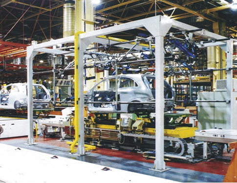

About 20 years ago, manufacturers began installing laser-sensing stations at the end of assembly lines. These stations used large mechanical frames to mount a number of 3-D laser sensors around the component for inspection, as seen in  figure 1. Each laser sensor measures a critical feature for deviation from nominal for every production assembly.
Figure 1: In-Line dedicated laser-gauging station
The laser sensors used can measure a number of different parameters, depending on the measurement type required. Laser-line triangulation techniques measure surface, vertex, and edge positions. Grey scale imaging is used for feature locations such as hole and slot positions, and weld nut positions. Both capabilities are combined in a single sensor package, including laser and surface illumination.
As part of the sensor manufacturing process, each laser sensor is individually calibrated against a series of precisely positioned artifacts to ensure accuracy of measurement data. The sensors are fully solid state, with no moving parts, so recalibration in the field is not required unless physical damage occurs.
Because these dedicated in-line measurement stations are located on the plant floor, they are subject to significant seasonal changes in ambient temperature. As part of the sensor manufacturing sequence, each individual sensor undergoes a complex temperature compensation process to correct for any thermally induced variations.
The measurement speed of laser sensors in these fixed measurement stations gives the station the ability to measure every component, providing complete documentation on 100 percent of production—a dramatic improvement over the CMM or check fixture.
Systems are typically equipped with data collection, archiving, and automated statistical analysis software for trend analysis, and an alarm function to indicate when user-defined limits are exceeded. Such software also reports both raw data and trends in all common reporting formats, in simple to understand color-coded graphical formats, and measurement data is available on the plant network for remote viewing. These end-of-line stations have been broadly implemented in industry at major automotive manufacturers in the Americas and Europe.
