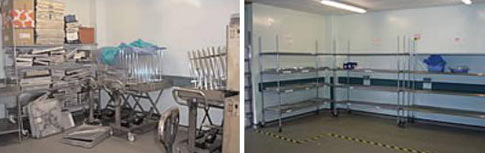

The HSDU at the New Royal Infirmary before (left) and after (right) Six Sigma process improvement
The hospital sterilization and disinfection unit (HSDU) at the New Royal Infirmary is one of the busiest in the United Kingdom, processing more than 7 million reusable instruments each year. It employs more than 100 staff operating 24 hours per day, 365 days per year, and has been in operation since 2002.

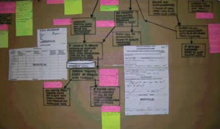

Process mapping (see image below) was particularly critical to the success of the project. Detailed process maps were created and used to identify the potential sources of the contamination problems. It was also a superb method for getting maximum participation from the team members and focused problem identification.
Example of process mapping

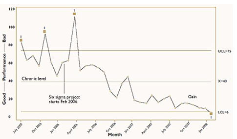

The key target was the reduction of risk due to contaminated trays, and this was achieved. With hindsight, secondary targets were too ambitious but even so were eventually achieved. Future projects will take into account the need to set realistic secondary targets in the unit, but the graph below clearly indicates the positive gains that the unit achieved. The old “chronic” level of contamination was overcome and, more importantly, maintained.
Number of contaminated trays per month
