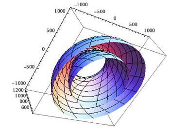

If an offset is introduced on the second joint (a1 ≠ 0) we observe that the hemispherical shell collapses into two shells, shown in figure 5. The outer shell corresponds to axis two being oriented in the same direction as the offset (yielding a larger radius), the converse is also true.
Figure 5: The surface described by the end-effector of a 2-axis arm with an offset second link.
The two effects described may also be combined, resulting, as one might anticipate, in a split shell with an inaccessible dome, shown in figure 6.

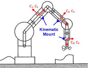

Compliance model and FEA tests
We have thus far concentrated on movement of the RCA--the driven exoskeleton--but what is important for a metrology unit is the behavior of the internal measurement arm--the ICA. The ICA moves inside the RCA, held in place by three kinematic mounts which provide both support and the contact forces necessary to move the arm within its exoskeleton. Figure 9 demonstrates an early RCA prototype, showing the approximate positioning of the kinematic mounts which surround axes 3, 5, and 7.
Figure 9 : Schematic of the RCA and ICA units, demonstrating placement of kinematic mounts and associated contact forces, Cn. Adapted from [1].
Throughout development of the RCA product the design and placement of the kinematic mounts have changed considerably, owing in part to the results of Finite Element Analysis (FEA) tests and a compliance model describing the static forces acting on the ICA.
Early in the product development it was discovered that the repeatability (and hence system accuracy) was considerably less than expected in certain poses. A Finite Element Analysis, shown in Figure 10, confirms that in some configurations the ICA is subject to extreme constraining forces, causing it to distort.

By considering the static forces acting on each ICA link it is possible to determine the contact forces, Cn, supplied by the kinematic mounts. Taking moments about three axes and resolving forces in three directions for each of six ICA joints yields a set of 36 equations. These equations may be solved simultaneously to determine the internal reactions at the hinges as well as the six contact forces in terms of the known weights of each ICA link. Results of the compliance model, a sample of which is included in Table 2, are in close agreement with those obtained from FEA.
Conclusions
The results of geometric modelling have a number of implications. Applying Pieper’s Solution to the RCA provides a computationally efficient shortcut to the desired solution to the inverse kinematics problem, thereby improving the performance of the route planning software. The accessible workspace map provides a useful tool for the end-user to determine the feasibility of a candidate scan specimen and identify its optimal location within the RCA workspace. This maximizes the dexterity of the unit and minimizes the amount of time spent moving the part and/or robot.
The knowledge of the inflated constraining forces has shaped the design and placement of the kinematic mounts significantly. Recent prototypes include clearance, permitting a little lateral movement under pressure rather than remaining rigid and causing deformation of the ICA.
In general a system should have a number of constraints equal to the number of degrees of freedom; the most recent kinematic mounts satisfy this condition by requiring that each constrained axis is required to pass through a fixed point but is otherwise free to rotate and slide longitudinally. These upgrades have led to a marked improvement in system accuracy in the last six months.
